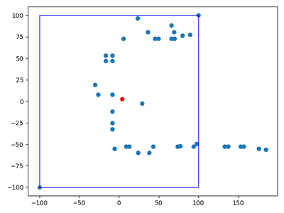

Hey all,
I am trying to get coordinates of objects on a sheet, as oppose to coordinates of the element in the model.
I am generating XPS, then PNG files of the viewsheet at 150 pixels per inch. So that is my scale. From what I understand according to this post the units are in feet, however that does not seem to add up for me. Because I can see there is both a translation and scale transformation for the elements locations to align with the coordiantes from get_BoundingBox.
This is the sum of what coordinates I am executing:
var bounding = element.get_BoundingBox(viewSheet);
File.AppendAllText(path, $"{element.Name}, {group.Key}, {bounding?.Max.X}, {bounding?.Max.Y}, {bounding?.Min.X}, {bounding?.Min.Y}\n");
Where viewSheet is a ViewSheet  object.
I tried looking at viewport.get_BoundingBox(viewSheet);. But that seems to give me numbers that are too small in relation to the sift need for the elements to the right location on the sheet.
How would I get the exact location on a XPS/PDF sheet of an element?
Accepted solutions (3)
16,083 Views
29 Replies
Replies (29)
Message 3 of 30
Hey @jeremytammik ,
I went over a few of your blog posts, and now over those two in particular.
What I am doing is a little different, because I am eventually trying to figure out the coordinates on an XPS file (or PDF). So I don't only need the coordinates in relation between the sheet and the viewport, but also between the sheet and the actual XPS.
I've been trying different things in the past few house using the rac_basic_sample_project.rvt plan from the example projects.
For simplify I am using the sheet A1 - Floor Plan. Which has origin at 0 and scale 1 so I know that its not a problem as described in your second link (unless if there is a difference between a Plan class and a SheetView class that I am missing).
I am drawing all the doors, and it seems they make a shape that resembles the door order, so I know that this gives me the door elements in some coordinates system:
However I can't figure out which one, and then I don't know how to plug that back to the sheet.
The door values move form -50 to +180, plotbelow.
I also draw a rectangle of (viewSheet.Outline.Min.U,viewSheet.Outline.Min.V), (viewSheet.Outline.Max.U,viewSheet.Outline.Max.V). Which is -100, 100. That does not add up because there are doors further out at +180.
I was generally looking for coordinates that added up will pass 180 so I know all doors are included.
But all of the following values yielded number below:
var viewsheet_bounding = viewSheet.get_BoundingBox(viewSheet);
var outline = viewport.GetBoxOutline();
double scale = Convert.ToDouble(viewSheet.Scale);
viewSheet.Origin.X / scale;
viewSheet.Origin.Y / scale;
var viewport_bounding = viewport.get_BoundingBox(viewSheet);
viewSheet.Outline.Min.U; //  shown above in plot
viewSheet.Outline.Min.V; //  shown above in plot
All these give far too smaller numbers.
I also tried rac_advanced_sample_project.rvt  with similar results at the sheet E201 - Unnamed floor.
Can you point me what kind of data am I missing to do coordinate transformation, namely the translation?
(I found that the scale change is about ~3.8 for 150 DPI, I am not sure why because I don't know the units, but at least I can do that empirically there).

RPTHOMAS108
The first thing to note is that you are using rac_advanced_sample_project.rvt not the basic project since this is the only project with the named view sheet you mentioned.
I've included some code that plots bounding box position of doors to the sheet coords system. The transform is important even for plan views as although these usually align with the model coord system sometimes they are rotated:
The sheet coord system is from bottom left to top right. I don't know how the system in PDF/XPS is measured but a further translation may be required. It is important to note that the title block can be placed anywhere in the sheet space but when it is printed this space obviously gets truncated to the extents of the title block. Therefore the location of things relative to the title block is more relevant than the absolute sheet coords themselves.

Hey RPTHOMAS108,
Where I am currently stuck:
The following function is missing and I can't find it in the API so I expect you extended it:
J1.DrawPoint2D(Doc, 0.01) 'EXTENSION METHOD
I could try and run your code if you provide it. That would give me something to try out and see how I get it to work with the rest of my C sharp code.
Here is more detail:
I know a little of VB script and C#, I tend to do most of my daily stuff with Python. None the less I want to get this working end to end in any language first. Only then I will be conferrable translating between languages. Its 130+ lines I will likely make a bug without feedback from running code.
I have have a "hello world" program IExternalCommand.Execute compiled and working both for VB and c sharp. So pick either as long as its consistent.
Thanks for pointing out the right file and trying it out.

Message 8 of 30
Ok, great!
It now compile and I get these cross shapes next to doors:
I have an idea how to solve this now without making complex calculations to where the objects are in the PNG. And not knowing what is trimmed etc.
What I want to do is draw these crosses, but in a specific RGB color. That way I can create two PDFs, one with the RGB crosses, and extract the Rasta images locations. Ideally I want it to be a single pixel and not a cross, Or at least a small circle like you posted in the previous comment.
Is there any way to do that?
Attaching current code.
Message 9 of 30
RPTHOMAS108
You can't draw a line that is less than the value set given by Application.ShortCurveTolerance
The red dots were actually the same cross markers but with thin lines turned off in the UI and they were 0.01 ft in length rather than 0.02 ft.
If you know the width of your sheet in pixels and you know the width of your sheet in feet then finding the location of a point can be done by proportions (e.g. similar triangles).
X_Pixels / SheetWidth_Pixels = X_Ft / SheetWidth_Ft
X_Pixels = (SheetWidth_Pixels * X_Ft)/SheetWidth_Ft
e.g.
512 = (1024*0.75) / 1.5
With a sheet width in pixels of 1024, a sheet width in Ft of 1.5 and an X ord in Ft as 0.75 (half the sheet width).
This is not overly complicated but I've lost track of what you original task is exactly? In most cases pdfs produced by Revit contain vector graphics so what is the PNG about?
