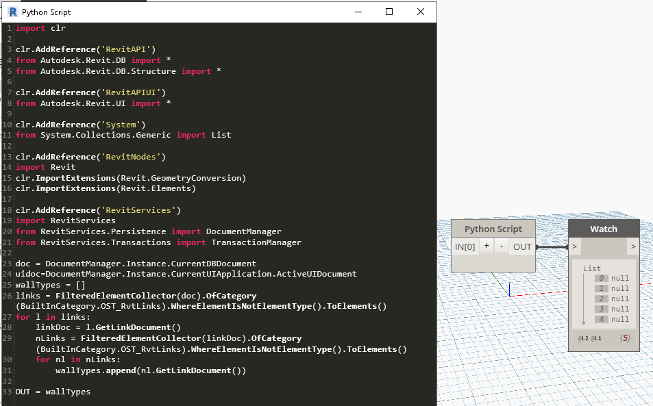

Even though I am able to collect the nested Revit links within a Revit link, and get some of its properties, I am unable to get the nested link's document like I can its parent link.
The python script goes as below:
linkDoc = selectedElem.GetLinkDocument() linkTransform = selectedElem.GetTotalTransform() #Get Nested links nestLinkCollector = list(FilteredElementCollector(linkDoc).OfCategory(BuiltInCategory.OST_RvtLinks).WhereElementIsNotElementType()) linkElemCollector = [] for nl in nestLinkCollector: nestLinkDoc = nl.GetLinkDocument() nestLinkElemCollector = list(FilteredElementCollector(linkDoc).OfCategory(BuiltInCategory.OST_IOSModelGroups).WhereElementIsNotElementType().ToElements())
I can get the nl.Name property, but the nl.GetLinkDocument() call returns null/None. Thus, I am unable to retrieve elements within the nested Revit link as I can in the regular Revit UI.
Any tips would be appreciated.

@AnonymousI have some interesting although not entirely helpful results. Perhaps a post on the Dynamo forums may yield you more support for Python if you don't get an answer here.
1. I was able to reproduce you issue using Python via Dynamo
2. However, I was NOT able to reproduce this in C# via add-in. It worked as expected.

I've faced this also. Revit apparently treats nested links as "normal" links (you can Tab select them and copy out of the mainlink file, go figure!) Behaves something like nested groups
The way to go depends on what you want to accomplish.
A. If you want a list of all modelgroups per link (not in treeform) then:
1.  use FilteredElementcollector on active project by OfClass RevitlinkInstance or ByCategory OST_RvtLinks
    (this will also include the nested links!)
2. Loop all links and retrieve modelgroups as in your code
B. If you want a list of all modelgroups of a picked link (You also can pick a Nested link! with Tab select)
1. Use the selected revitlinkinstance to retrieve the modelgroups.
C. If you want a list of all modelgroups of a picked Top-level link and from it's nested links (this will be tricky)
1. Pick a top-level link
2. See if selected link has nested links (and get the Fullpathnames per RevitLinkType !)
3. If yes, then retrieve all links from active model (FilteredElementcollector OfClass RevitlinkInstance etc) and also get all the RevitLinkType FullPathnames
4. compare the RevitLinkType fullpathnames to get the correct one(s) and retrieve the modelgroups from it.

In the C# code in the second ForEach loop you also reference to fec.ToElements, it retrieves the elements from the first Collector. If you replace it with the linkfec collection the second loop creates a error, no document retrieved.
The nested walls appear to be retrieved because Revit retrieves all links (including the nested ones) in the first FilteredElementCollector.
So I think Python and C# retrieve the links identical.

No I don't think so, it's just the way it's implemented in Revit API.
The GetLinkDocument can only be retrieved from a instance in the workable project, this includes the nested links.
So nested links info/data can be retrieved, how you code it depends on the desired endresult/workflow of the addin.

Ah! I see the issue now. In my python script, I was relying on the user to select which link they'd want to retrieve the data from. The script then sought to filter any nested link within the selected link, which returned those aforementioned errors.
In  @Sean_Page 's C# attempt to reproduce the issue, they instead filtered all links from within the host doc, which included nested links. This, combined with your suggestion to use "RevitLinkType" to match the path of the user-selected link will provide what I need to proceed.
