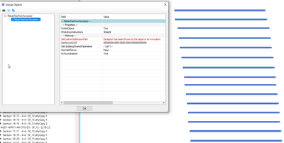

Is there a way to group up rebars without using RebarContainer command and loading the distribution path data?
Furthermore, There is something strange going on when creating a rebar container. Its distribution path is not correlated to the actual true distribution path

Question 1:
There are two types of Free Form rebar:
  1. The one created from curves, and which doesn’t have any constraints to the host. The input curves for each bar in set can be in any position and it is not possible to set a distribution path for it. An example of such rebar is the sketched free form. To create such Rebar you should call       public static Rebar CreateFreeForm(Document doc, RebarBarType barType, Element host, IList<CurveLoop> curves, out RebarFreeFormValidationResult error);
  1. The one created through a server (callback), and which has constraints to the host. Any time when the constraints are modified, the server is called to recompute the Rebar curves. During this calculation, a distribution path can be set too. This distribution path is a list of curves. Aligned and Surface distributions are examples of such free form. To create such Rebar, you should use public static Rebar CreateFreeForm(Document doc, Guid serverGUID, RebarBarType barType, Element host). Look also at the documentation for IRebarUpdateServer class. In the RevitSDK there is a sample that demonstrates how such a free form rebar can be created.
Question 2:
RebarContainerItem is created from a Rebar element (which is a set) and has its own number of bars and of course it will have its own distribution path which is the source Rebar’s distribution path. RebarContainer is just storing a list of RebarContainerItems without having any relations between them.
