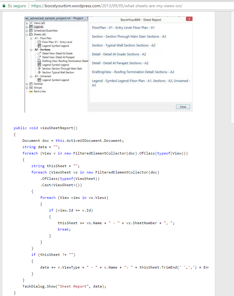

I found the following code   But it produces an error
I am working revit 2015 and sharpdevelop
Sub Button4Click(sender As Object, e As EventArgs)
        Dim doc As Document = commandData.Application.ActiveUIDocument.Document
    Dim data As String = ""
    For Each v As View In New FilteredElementCollector(doc).OfClass(GetType(View))
        Dim thisSheet As String = ""
        For Each vs As ViewSheet In New FilteredElementCollector(doc).OfClass(GetType(ViewSheet)).Cast(Of ViewSheet)()
            For Each view As View In vs.Views
                If view.Id = v.Id Then
                    thisSheet += vs.Name + " - " + vs.SheetNumber + ", "
                    Exit For
                End If
            Next
        Next
        If thisSheet <> "" Then
            data += v.ViewType + " - " + v.Name + ": " + thisSheet.TrimEnd(" "C, ","C) + Environment.NewLine + Environment.NewLine
        End If
    Next
    TaskDialog.Show("Sheet Report", data)
    End Sub

rodrigohbm
in reply to: matthew_taylor
I am trying to generate a sheet report
The code itself I got it from a web page but this was in C#
But when transforming it to vb.net
Generate version errors
And that's where I'm locked
