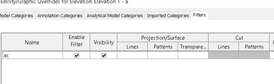

Let's say I've created a filter without using the API, then I want to set it in other views:
So far Revit lookup identifies my filter view as a ParameterFilterElement and I'm making this task work bypassing its Id to a ElementId class, then I deploy the view.AddFilter() class. However, ironpython throws me back the following error :

How can I query the filterElement Id of an actual View filter manually built without using API

If the element you created is database resident, you can explore it interactively using RevitLookup. For instance, add the filter manually via the UI and use RevitLookup and other tools to determine how that affects the database afterwards:
https://thebuildingcoder.typepad.com/blog/2017/01/virtues-of-reproduction-research-mep-settings-onto...
That should enable you to determine the element id you need as well as where it is stored and thus how it can be retrieved programmatically.
