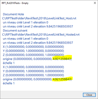

RPTHOMAS108
Works with either TotalTransform or Transform, think TotalTransform is for transformed instances within links rather than links themselves but to be honest I've never needed to use it.
If the instance is orientated to the space it lies within then identity would be expected regardless of level offset.
In the below you need to add 4.9 to the 9.8 value to get the actual level of the linked levels. If you are creating levels in your model based on a linked model then you really need to acquire co-ordinates if you want your level values to match in elevation. You need to tell your model where the elevation base should be to have the created levels in your model reflect the true value (according to the relative link position and its elevation base offset).
Blue levels = linked model selected
If I want the black levels to be representative of the blue then I need to acquire co-ordinates which will change black level 1 to -1.5m (-4.921 ft). Alternatively if I publish co-ordinates then blue level 1 will change to 1.5m etc. The transform will tell me where the levels are in my model but the created level will have nonsense values until I acquire coordinates from the link (assuming link has correct levels and you want to acquire rather than publish).

RPTHOMAS108
If you linked in the other model at 0,0,0 and it is parallel to the model co-ordinate system then there is no obvious reason for the .GetTransform functions but this isn't often the case for two models created by separate teams from separate templates.
The GetTotalTransform function is also used in nested family instances i.e. what is the placement base point (origin) and orientation (basis) of a nested family and how does this relate to the model space the host family is located in.
In relation to the .IsIdentity property it is probably badly named because the transform works based on a 3x4 matrix so how can it be identity? I think we understand it to mean that it is equivalent to a 3x3 matrix with origin set to zero and basis x,y,z pointing to their respective global axis i.e. no change from original and transformed geometry. When you use .OfPoint origin is considered when you use .OfVector origin is ignored. A transformation without origin has no translation.

RPTHOMAS108
According to the internal co-ordinate system your models share the same origin and alignment.
Please clarify:
  1. if you are inserting by origin to origin or shared coordinates?
  2. How are you coming to the conclusion there is a translation between your models (from Revit level values or reading internal co-ordinates)?
  3. When you state two different level values for bottom level are different are they set to Shared or Project? If both set to project then do the differences in level still not relate to the physical gap between them?
  4. Note that you cannot set a level to be measured from the relative location but you can set an elevation marker to this, as below. In the below example -0.366 is actually 0 in terms of internal co-ordinates. In the lookup and on the level class this is noted as ProjectElevation but that is confusing terminology since it isn't relative to project base point (which can be moved just as the survey point can).
