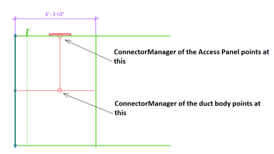

So far, I can use the "Origin" of the connectors (in ConnectorManager) of a duct-body and an end-cap to link them together.  They turns out to be the same if the end-cap is attached to the duct.  I can also use the same way to link a volume damper to a duct body.  This is the good news.
The bad news is that I cannot use this method to link an Access Panel to a duct body that it is attached to.  I also cannot use this method to link a duct (such as Boot Tap) to a duct body that it is attached to.  The common characteristic of these 2 cases is that the Access Panel and the Boot Tap are attached to the "side" of a duct body instead of attaching to the end of the duct body.  The Origin of the connector in ConnectorManager of the duct body is actually pointing at somewhere along the center line of the duct body.  On the other hand, the Origin of the connector in ConnectorManager of the Access Panel is pointing at the attachment point on the side of the duct body.  The difference is shown in the picture below:
I need a way to determine if the Origin of the Access Panel is along the center line of the duct body with a distance of half of the duct body width.   Or put this in another way: How to project outward a point that is along the center line of a duct body to the side of the duct body?  Please note that an Access Panel tends to be placed in the middle of the duct body (in term of depth).  Therefore, I don't worry about if the Access Panel is placed 3 inches above the center line or below the center line.  This is all just an approximation.
I used to use functions Item.GetConnectorWidthVector() or Item.GetConnectorDepthVector() in Fabrication API to solve this problem.  Is something like these available in Revit-API?
Please let me know if such a function available.  Thanks in advance.

I believe I can project the point in the center line of the duct body to the side of the duct body.  This is based on the nature of ductwork.  Ductwork is always laying flat.  It can go up or down.  But it won't rotate along its center line axis.  This means I can use the center line to create a vertical "surface", and then use Surface.Project() function to see if the Origin of an Access Panel is close to one of the connector of the duct body.
I believe this should work, and I will find out if this really works.

You can query a fabrication part for its connector manager and retrieve the connector objects from that. Each connector has a location. The location can be used to determine other neighbouring parts. The neighbourship relationships can be used to determine the graph of connected parts. A similar approach is used by the TraverseSystem SDK ample that I pointed out. Here is a code snippet accessing a fabrication part's primary connector and using that to determine its local coordinate system:
