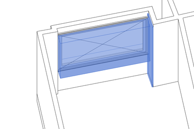

I've this room
And it can be seen that the window is hosted to the left wall:
Now I'm trying to get paint areas of the wall that bound a room which includes to substract area of the openning.
What happens is that the FindInsert method for the right wall is retrieving the left window opening somehow
This is the final geometry I get when I loop through this wall before throwing the exception:

I solve this by making sure the id's retrieved from the method findInserts have a host element Id equal to the wall I'm into. Nice source by the way. I'm checking it now
