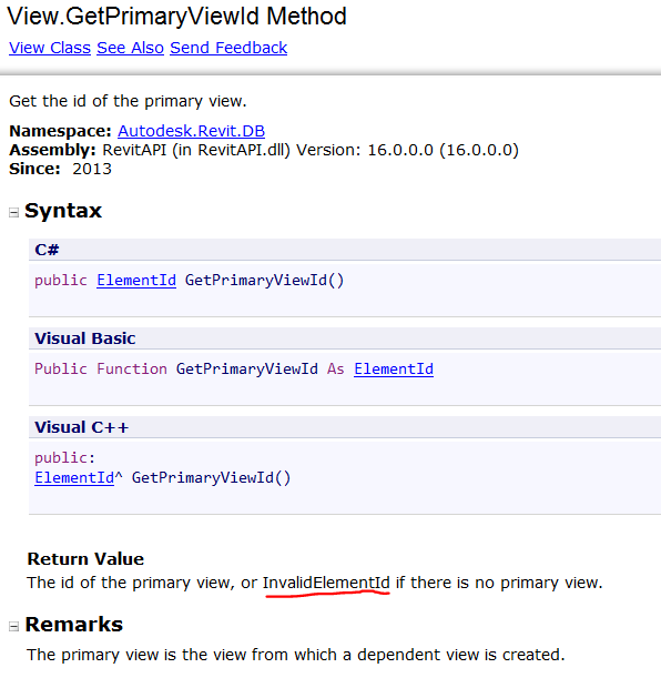

How to filter all dependent section through API.

using a filtered element collector, collect all the elements that are of type ViewSection and that have a view.getprimaryviewid() as a valid elementId
