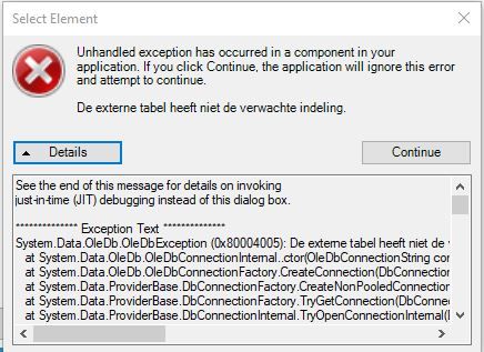

I have a code (see below)that can load an excel file xls and xlsx in visual studio. This code i'd like to use in Revit. It is working with xls files but when i want to load xlsx i get the following error message. Is this because it isn't possible to read xlsx? i that case i will stay with xls. But maybe it's a simple solution that i couldn't find

MexicanCustard
Without getting into checking that OleDb is setup up or that you have excel on the target machine.  Look at using libraries like ClosedXml and SpreadSheetLight instead of OleDb. There are lots of open source libraries out there that don't depend on Excel being installed or a connection being setup in the OS like OleDb.
vanlion
Hi MexicanCustard,
Thanks for the reply! So it has something to do if Excel is installed or not.
I will google the solutions you said. Also i saw a package ExcelDataReader you can download for free.
I only don't know how it goes with rights when you sell the code
vanlion
For working with .xlsx i used OpenXml and that is working but can't open older files. But the company the addin is build for doesn't use older versions 🙂 it only has some trouble with Google spreadsheets saved as xlxs
