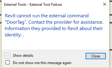

Hi people. Having a bit of trouble loading my dll file into Revit.
I am getting the following error message:
I know for certain it has something to do with how I am structuring my IExternalCommand and My IExternalApplication. I have a main class that talks to the extensions classes (to execute the various commands) which I have used IExternalCommand as follows.

Does anyone know what I am doing wrong?

Hi @jeremytammik
 Thank you for the advice. Love your blog by the way!
Although I eliminated the first error, I am still getting this error message after trying your second suggestion (which seemed the safest):
I have a feeling that the C# template for Revit is made for Revit 2018 which means by 2016 Revit doesn't have a good time trying to read the file. It is either that or I haven't registered by addin, properly. another
Another idea is that the classes are not reading the various extension classes well. I have multiple classes within my project including a 'App' class that gives me my new icon and command button, a 'Command' class that gives me my new entry point to the Iexternal command, and then I have multiple other classes like 'FamilyInstanceExtensions' and 'IndepependentTagExtensions" that the 'Command class references to perform its function. Let me know if I should
What do you reckon I should do to fix this? If you need more info, I can post my source code but I am not sure how much difference it will make since I used the template that your most up-to-date github template produced and everything is compiling fine. From what it appears like, it is just a loading error. PLEASE HELP ME!
