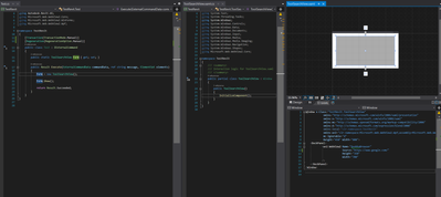

Hi there,
I am trying to create an Addin for Revit which will simply show a WPF window with an embedded web browser.
I'm using webview2 to try and achieve this however I'm encountering an error when testing it in Revit the window displays but is blank and empty. When debugging it does show the web browser to be there  all though its not.
When I run the exact same code to create the window with the embedded browser by itself it works it just doesn't work when inside Revit. I've debugged them both at the same time comparing properties to see if theres a difference and there isn't they line up to be the exact same.
I've also tried CEFsharp which doesn't work either.
I'm lost for ideas on what to do, try and/or fix to make this work. Any ideas?
Cheers,
Jesse

Thanks for the reply. I've attempted that example previously but its a bit more complicated then what I'm trying to do. I simply want a window in Revit to show google.com
My code consists of the base command cs which runs when the button is clicked in Revit that shows my wpf xaml file that holds a WebView element when. When I debug in Revit, I receive no errors and the code even says the WebView element is there however the window only shows a blank window.
Cheers, Jesse
