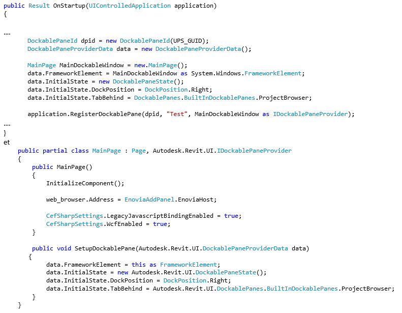

I am using a dockable panel embedded in Revit with the following sample of code:

However, when I start to open a second model in revit and switch from a window to another, I usually get this unwanted behaviour:
  • Wrong display of the element into the dockable panel
  • Dockable panel is frozen (no interaction is possible)
Do you have any idea on this topic?

I use the ViewActivating event handler to pass the correct "doc" to my panes and update as needed.

what function do you use for the update? and on what object (on page or webwroser)?
Sean_Page
Like I mentioned, using the ViewActivated event, I just simply call an internal void method on the panes code behind that updates t/ refreshes the information inside the pane. I also have the Document opened and Document hanged event handlers calling the same method, of which the doc is a variable.
