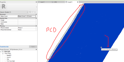

Greetings to all, I want to let you know a small issue I am facing when writing a set of points from a pointcloud into a text file, performing some operations between them, and later when I'm reading this data and placing some generic models at their location, the items appear close to the location they are suppose to be but not at the exact position.

4). Here is the deviation between the boundaries.
The same deal occurred in a previous task that has to be with surface reconstruction. The mesh was placed 30 feet away from the original point cloud data (PCD) location.
We do also deployed the ConvertToInternalUnits method at step (3) to perform units conversion. Any thoughts on this one that heads me into the right direction to import my data correctly?

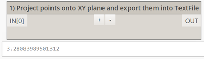

MiguelGT17
Actually, the cloudpoint is using revit system coordinates so it gets exported in Meters as that is the system unit  that has been set to my project.
I was looking up the GetUnitsToFeetConversionFactor() method as it might have something to do with the deviation issue but I'm confused where the GetScale() method comes from in Jeremy's samples:
https://github.com/jeremytammik/RevitSdkSamples/blob/master/SDK/Samples/PointCloudEngine/CS/FileBase...
Hi @jeremy_tammik !, is there any particular command that gets Revit to pull the exact coordinates from the point cloud data?  I was implementing the implicit operator that converts cloudpoint into an XYZ point but not did not succeed at this: XYZ(Cloudpoint)
and XYZ(cloudpoint.X,cloudpoint.Y,cloudpoint.Z) place the data close to the exact location

MiguelGT17
Thanks for replying me mhannon! I was not aware of the PointCloudType class. I'm very thankful to you for noticing me that. So far Scale property seems to throw back a pretty curious value.
The offset property scared me a little bit, but I will see what I can come up with it
Actually it's my bad, I assumed that the pointcloud origin was placed at 0,0,0 coordinate but somehow when I import the cloud it gets fit at slightly different origin:
by considering that vector, the points are placed correctly
