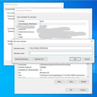

vbondar
We have an issue with crashing Revit on startup after the installation of our plugin (after deinstall Revit works well again). We cannot see any entries with our plugin loading in the log files that are created by Revit. It can be reproduced only for one particular user. Are there other places where you can determine the reasons for the crash of Revit besides the logs?

jeremy_tammik
I am not aware of anything except the log and journal files. Your add-in can add entries to the journal file as well, you know. Also, you can equip your add-in with logging messages and save them to disk before it crashes. Can you run your add-in in the debugger on the customer machine? I also asked the devteam for further advice for you.

vbondar
Thanks, Jeremy. We are starting writing our own logs to disk at the start of OnStartup and it is not working. So it seems like the reason can be even before it. For now, we have no ability to debug on the customer machine. If we cannot find other ways in determining the reason we will start a discussion about debugging with the customer (I think some legal things should be clarified in such cases in our company).

vbondar4AC5Q
The user with the current issue created a dump file on Revit crush by enabling collecting User-Mode Dumps for Revit.exe (https://docs.microsoft.com/en-us/windows/win32/wer/collecting-user-mode-dumps) and here is some info from there (Debug with Mixed):
- module version: 21.01.50.27
- module original location: C:\Program Files\Autodesk\Revit 2021\RevitAPIUILink.dll
- Unhandled exception code: 0x80131623
- CLR version: 4.8.4420.0
- OS version: 10.0.19043
But since API users have no PDB files for Revit debugging, I cannot see the core issue. Is it possible to somehow find out the reason for the crash by providing this dump file and logs (where there are no lines about our plugin) to Autodesk?

vbondar
I apologize for my long absence. The reason for it was due to the environment variable COR_ENABLE_PROFILING (link - https://learn.microsoft.com/en-us/dotnet/framework/unmanaged-api/profiling/setting-up-a-profiling-en...) being set to 1, and the plugin being obfuscated with anti-debug options. Windows attempted to profile something, but it was unable to do so because of the obfuscation. This resulted in Revit crashing, possibly due to the inclusion of the obfuscated dll in RevitAPIUILink.dll.
