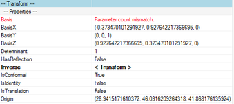

MiguelGT17
Actually I've made a code mistake as I was nailing it overnight. The next subject that I am working on has to be with transforms. I've read your post about that topic on https://jeremytammik.github.io/tbc/a/0290_abg07_transform.htm
then if I want to get the coordinates of my study point with respect to the section view coordinate systems (x'=right direction, y'= up direction, z'= view direction) I will need to follow the next steps:
1). Get the view cropbox transform
2). Wrap the basis and origin value in a M matrix. Then Multiply M with the Study Point. So far, I acknowledge that OfPoint() comprise this operation.
3) Script:
Study point: (24.973068124511, 55.8886371936385, 54.430719963225)
view = doc.ActiveView
cropbox = view.CropBox
transform = cropbox.Transform
NEWpoint = transform.OfPoint(XYZ(24.97306812451155.888637193638554.430719963225))
Indeed, OfPoint() Method is determining a point that has non sense pertaining to view coordinate system as it lays on the view plane, and therefore the z' basis should no depict a 97.75 value. (it must be less or more between -1 or 1)
secondly, If I repeat the same process to the point ( 32.909966197563436.174604659224954.430719963225) that is located to the left off the section view origin, the x' keeps a positive value (67.14).
Am I skipping or misunderstanding something here?  I would appreciate hearing some thoughts from you Jeremy.
Thanks in advance,
Miguel G.

RPTHOMAS108
There are two subtle things about this process:
Firstly I believe you are looking for the inverse transform, converting picked model locations to the local view system for cropbox.
Secondly your max and min diagonal points must relate to the view system so that every ord of min is less than every equivalent ord of max. You can't just pick two points and transform them you have to create two new points after transformation based on the max and min of each transformed coord.
I think there is the posts out there that provide details for this process. In the above I assume you are not intending to change the view direction?
MiguelGT17
Dear Thomas, Absolutely, pertaining to Jeremy's blog I should've been using the inverse transformation from the section view.
Currently I'm aiming to get the location of a rebar reinforcement(by taking the mid point between BB.min and BB.max) and then determining its X and Y location in the local section view system by making use of the Inverse transformation so I can place multi-rebar tags. I am set to go and continue working on the script, many thanks to both of you!
