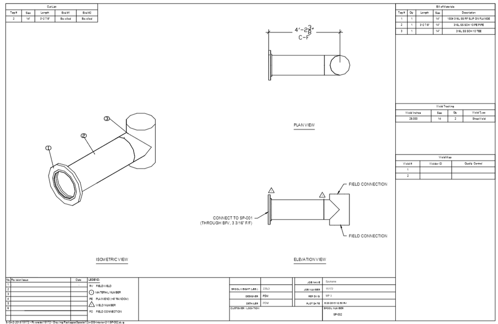

Hey all, I've been digging and looking and trying to find a hint as to how to do this, but I'm not having any luck.  I wrote a tool to essentially overwrite the "Create Assembly Instance" button in the Modify tab, with a little extra added on to it.  What I'm trying to accomplish is to take the AssemblyInstance I just created and create a new Sheet with several Views from it.  Essentially something like this:
I have a couple Families that I've created to populate the data, and Shared Parameters as the data.  I'm just not sure how to create the whole thing with the Iso, Side and Top-Down views.  Do I need to create the whole sheet as a Family, and have it inherit the other Families and views?  If so, would creating that be like creating other Families, or is there something special I need to do?
Any guidance is a huge help.  I've been stuck on this for a couple days.
