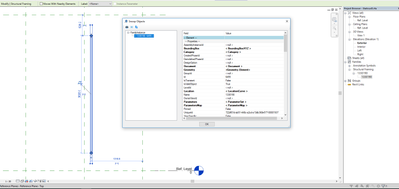

Hello, I am struggling to place an instance of a profile family on a work plane. I am not sure if I am moving to write direction, so maybe someone could check my code or give a link to solution how to place family instance on a work plane.
ReferencePlane frbackPlane = null;
// get a reference plane FilteredElementCollector planescollector = new FilteredElementCollector(RvtDoc.revdoc); ICollection<Element> planesInProject = planescollector.OfClass(typeof(ReferencePlane)).ToElements(); foreach (ReferencePlane planeEl in planesInProject) { if (planeEl.Name == "Center (Front/Back)") { frbackPlane = planeEl; } } // place family instance
FamilySymbol famsym = RvtDoc.revdoc.GetElement(loadedfamel) as FamilySymbol; XYZ startLoc = new XYZ(0, 0, 0); XYZ endLoc = new XYZ(0, 0, 100); famsym.Activate(); famsym.get_Parameter(BuiltInParameter.FAMILY_WORK_PLANE_BASED).Set(0); FamilyInstance instance = RvtDoc.revdoc.FamilyCreate.NewFamilyInstance(frbackPlane.GetReference(), startLoc, endLoc, famsym);

I wanted to elaborate a bit o my question. Please fin an attached image below, which represents my goal. I believe I have to use NewFamilyInstance Method (Reference, Line, FamilySymbol)  method. However struggle to implement it as I get an error that Lines is not on face.

I'm not sure how you are getting your family symbol, but this works when ran as a macro.  I changed the family name to match one I had.  I assume you are aware this has to run from within the family editor, since its using the FamilyCreate method.

@stever66, thanks for your reply.
I have luck in  placing family instance with these methods : "NewFamilyInstance Method (XYZ, FamilySymbol, Element, StructuralType)", "NewFamilyInstance Method (XYZ, FamilySymbol, StructuralType)", however none of these assigns host element to my family instance. @JimJia  I need to create new family instance which would be placed on "Center/Back" work plane. It looks that I cannot change a default family placement type to work plane based and when I try to use  "NewFamilyInstance Method (Reference, XYZ, XYZ, FamilySymbol)" method, I get an error that FamilyPlacementType is not WorkPlaneBased.

thank you for the information. I cannot find such parameter "Work plane based" in my family. Does it mean it's not work plane based. As much as I know the family has been created using one of the structural framing templates coming along with Revit.
Message 8 of 10
stever66
Then it probably isn't a workplane based family.   A "hosted" family cannot be changed to a workplane based family.

@stever66
thanks for your reply. I have decided to place a dummy profile ( family instance) manually, thus I can select that it could be placed on a work place. Then with my code I  switch family symbols, make copies of that profiles and transform where I need. That's a bit nasty, but still a workaround.
