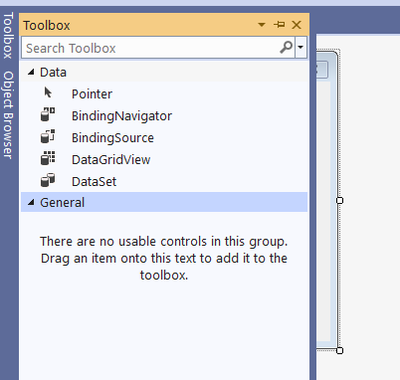

You and I are very odd in the universe. This is c# universe.
I am sturuggling to move my project to .net 8.0 which written in c++. Until now I couldn't find any solution. I created c++ project with winu because WindowsForm is not supported (Design view doesn't work). But I can't add RevitAPI.dll file as reference. It returns error "couldn't add a reference to RevitAPI.dll it is not a type or version current project can use"
Is tehre anybody have the same peoblem and solved it?

halukuzuner
Hi Cris,
I wrote the problem to Microsoft. Topic link is https://learn.microsoft.com/en-us/answers/questions/1663087/net8-windows-form-design-view-problem
This solution works. But it still needs adding form control by code. It is not comfortable.
I tried WinUI template in Visual Studio. But in that case I couldnt add RevitAPI.dll as reference.

Hi Chris,
Thank yo for your post. It didn't work for me. Think Microsoft Visual Studio has some limitations on c++. I created attached sample project.
Form designer tools are limited.
And it returns error "C1001 Internal compiler error."
Message 10 of 10
