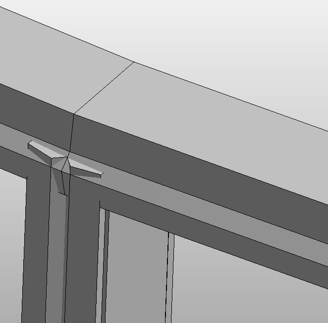

I successfully created an Extrusion. How can I change the colour of the resulting Sweep object, in this case from the Default Grey to black?

The problem is my ELement is a Family instance of a Sweep. So the Projection lines are in the right Color, but the Element itself is not really a solid, but just a composite of the projection lines. Thus the question becomes, how can I convert a FamilyInstance of a Sweep into a solid?
