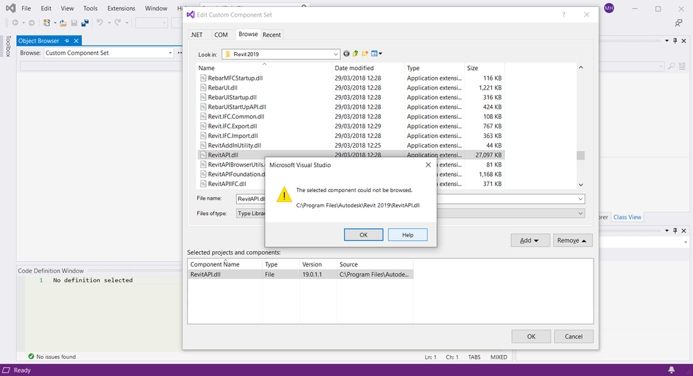

Hi I've encountered this error message: "The selected component could not be browsed" when trying to look into the Revit API namespaces in Visual Studio 2019. I'm new to both, but I believe I did the right thing to open Object Browser, direct to Custom Component Set and direct to RevitAPI.dll

Right mouse click on references in solution explorer, and click 'add reference', then 'Browse' and add both RevitAPI.dll and RevitAPIUI.dll
mengqi.huang
Thanks for the reply Joshua. I found out it was because that I didn't install the .Net core. Browse the .dll into Object Browser is just fine upon installation,

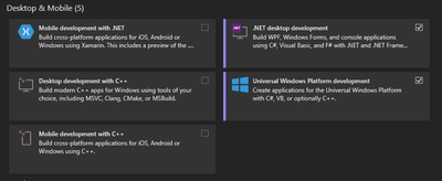

Had same problem, found solution- when you install VS you have to install these two packages:
.NET desktop development
Universal Windows Platform development
