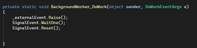

zefreestijl
Hi, thank you,
I tried implement the macro into my API tool and it worked as exactly what I need!
so what I missed was the ManualResetEvent for successfully receiving worker's current state,
then I can collect the element list or delete elements when the ExternalEvent been executed.
this method really simplifies the workaround.
Thanks again for your help :]
