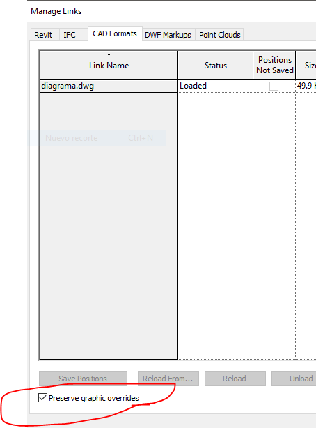

Hello friends
you can control the option (view image)
PreserveOverrides when it recharges the cadlink?
regards
Using t As New Transaction(doc, "Reload Imports")
    t.Start()
        Dim cadLink As Autodesk.Revit.DB.CADLinkType = TryCast(doc.GetElement(typeId), CADLinkType)
            cadLink.Reload()
    t.Commit()
End Using

You have to use the 2nd overload of the Reload method:
			CADLinkOptions opt = new CADLinkOptions();
			opt.PreserveOverrides=true;
			cadLink.Reload(opt);

Thank you.
to vb.net work in the following way.
Dim opt As New CADLinkOptions(False, typeId )
 cadLink.Reload(opt)
