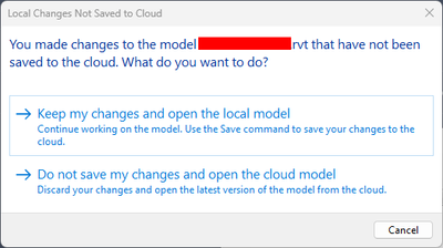

Hi all,
Has anybody managed to successfully save changes to several non-workshared cloud models using the Revit Batch Processor?
I need to make a small change to about 1000x models stored in ACC and not workshared. I can make the changes without issues but the saving process takes about a minute per model and the Revit Batch Processor seems to move on to the next model without letting the save process complete.
I've already tried multiple options (shown below) without success.

I'm using project and model GUIDs to open each model and a combination of a C# dll with a python script to run the C# method.
When I try to open one of the models a couple of minutes later I get the message below showing that I have a cached version of the model that includes changes that were never sync'd to the cloud model.
Thanks for reading.

floretti
Never mind. I found a different method for saving cloud models is available.
Instead of using doc.Save() I need to use doc. SaveCloudModel().
