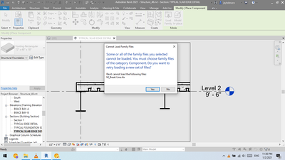

when I try to place the break line by component>load family>detail items it shows the error as in the picture.
Kindly, suggest if you have the solution

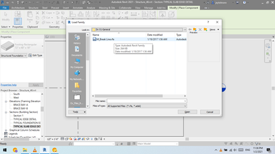

I have the same issue in Revit 2021. Try to use "Load Family" button from the "Insert" tab instead of "Component" from "Architecture" tab. It helped me!
Maxim Stepannikov | Architect, BIM Manager, Instructor
architect.bim
Or as another variant "Component" button from "Annotate" tab. It also works fine.
