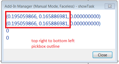

How is everyone sorting their min max?
public static Outline Outline(UIDocument uidoc)
            Selection selection = uidoc.Selection;
            PickedBox pickedBox = selection.PickBox(PickBoxStyle.Directional);
            double minX = pickedBox.Min.X;
            double minY = pickedBox.Min.Y;
            double maxX = pickedBox.Max.X;
            double maxY = pickedBox.Max.Y;
            minX = Math.Min(minX, maxX);
            minY = Math.Min(minY, maxY);
            maxX = Math.Max(minX, maxX);
            maxY = Math.Max(minY, maxY);
            Outline outline = new Outline(new XYZ(minX, minY, 0), new XYZ(maxX, maxY, 0));
            return outline;
Outline outline =  myFunctions.Outline(uidoc);
            double outlineDiagonal = outline.GetDiagonalLength();
            double outlineCenter = outline.GetDiagonalLength()/2;
            TaskDialog.Show("",$"{outline.MinimumPoint}\n{outline.MaximumPoint}\n{outlineDiagonal}\n{outlineCenter}");
Bottom Right to Top LeftBottom Right to Top LeftBottom Left to Top RightBottom Left to Top RightTop Left to Bottom RightTop Left to Bottom RightTop Right to Bottom LeftTop Right to Bottom Left
Message 9 of 10
aclarke
simply creating a new variable for sorted fixed the issue, bad python habit
            double sminX = Math.Min(minX, maxX);
            double sminY = Math.Min(minY, maxY);
            double smaxX = Math.Max(minX, maxX);
            double smaxY = Math.Max(minY, maxY);
            Outline outline = new Outline(new XYZ(sminX, sminY, 0), new XYZ(smaxX, smaxY, 0));
            return outline;
