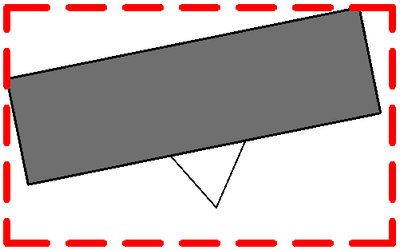

Hi all, I've got a challenge I haven't quite worked out how to tackle yet and some help would go a long way before I invest days into it.
I need to collect my FamilyInstances' BoundingBox, "move" their boundaries inwards by specific amounts (arrows 1 to 4 below) and collect the resulting corners (A, B, C and D below). Any suggestions on how to achieve that or places I can find small snippets of code which could potentially help? Much appreciated.
I'm very familiar with collecting the BoundingBox of elements but I realise I may need to get into some more advanced maths topics such as normals and vectors, which I'm not as familiar especially in the coding world.

Just reporting on progress, the good news is that I managed to find a way to get the new coordinates of points based on the distance and angle.
The bad news is that I just realised that the BoundingBox for something that's been rotated is like the red lines below, which shows that my original plan won't work. Back to the drawing board...

Ok, just reporting on progress, I managed to make the BoundingBox work by collecting the Symbol BoundingBox's 4 corners and applying the instance's point transform to each. The result is an accurate angled box, which I can then apply the formula shown above to each corner based on the instance's location angle and the desired distances (1, 2, 3 and 4). I'll keep going tomorrow and post the result here.

Then I am confused with the red dashed lines illustrated above.
Why in this case the BB is rotated from the element itself?
Message 10 of 14
floretti
@mizrachi_amir2 I believe the element BB never rotates and it stays aligned to the XYZ axis, even if the element is rotated, hence the red dashed lines. What I had to do to get the rotated BB is, get the Symbol's BB and apply the transform, which has the rotation information.
Message 11 of 14
jeremy_tammik
The bounding box is NOT rotated. It is aligned with the cardinal axes. The element has a rotation.
