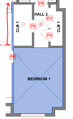

Hi everybody! hope this ticket finds you well
I've managed to create direct shapes as baseboard elements, the problem is that those shapes are not editable so I will need to use their location to place family instances. So the real issue is to get 1 of the bottom edges from a cubic solid
I'm using the following piece of code:
	                                                foreach (Face face in partialBaseBoard.Faces)
	                                                	PlanarFace planarFace = face as PlanarFace;
	                                                    if (planarFace != null)
		                                                    #region Method 2: use wall face orientation
		                                                    List<XYZ> pts = new List<XYZ>();
		                                                    //getting the face in contact with the wall (use the -)
		                                                    if (planarWallFc.FaceNormal.IsAlmostEqualTo(-planarFace.FaceNormal)) {
		                                                    	tailorBird.tessellateFaces(doc,face);
		                                                    	List<Tuple<Line, double>> lines = new List<Tuple<Line, double>>();
		                                                    	foreach (CurveLoop cvLoop in face.GetEdgesAsCurveLoops()) {
		                                                    		foreach (Curve cv in cvLoop) {
		                                                    			Line line = cv as Line;
		                                                    			if (line != null) {
		                                                    				if (line.Direction.Z <= 0.05) {
		                                                    					lines.Add(new Tuple<Line, double>(line,line.Length));
		                                                    	if (lines.Any()) {
		                                                    		lines =lines.OrderByDescending(x=>x.Item2).ToList();
		                                                    		Line theLine = lines[0].Item1;
		                                                    		XYZ init = new XYZ(theLine.GetEndPoint(0).X,theLine.GetEndPoint(0).Y,doc.ActiveView.GenLevel.Elevation);
		                                                    		XYZ end = new XYZ(theLine.GetEndPoint(1).X,theLine.GetEndPoint(1).Y,doc.ActiveView.GenLevel.Elevation);
			                                                    	if (init.DistanceTo(end) > doc.Application.ShortCurveTolerance) {
			                                                    		doc.Create.NewDetailCurve(doc.ActiveView,Line.CreateBound(init,end));
it works fine for the most part as it only retrieves one bottom edge.
The problem comes with this room called "STORAGE":
somehow in Line 32, I'm filtering one face from the direct shape solid, from it I'm only selecting the larget horizontal edge (Z direction value EQUAL to zero ) and for most rooms this code draws a single line in the space but for this storage room revit is drawing more than 1 line at the same place which doesnt make sense because I'm only passing 1 line as input. So there is not even chance to add overlaping filters between lines because I'm using 1 line as input.
  • 3 lines at same place from 1 cubic solid
  • 1 large line and 2 small lines:
Any ideas of what might be causing this issue?
In other rooms there are not problems at all
Best regards,
Miguel G.
PD: I'm attaching the Revit project with the direct shapes already generated so you guys can do the test

RPTHOMAS108
The first plan image above appears to be at a different location to the other two that follow it.
I suggest you isolate the wall and 'base board' element and step through with only those items.
There are only really two possibilities:
1) The additional lines are being dragged in from a local location via auto join. This doesn't seem to be related to that issue given where the smaller lines end up.
2) The additional lines are added for another element or iteration of the loop.
How do you relate the wall to the base board attached to that wall?
When you use Line.Direction.Z < 0.05 be aware that all vertical curveloops will have at least one edge predominantly pointing downwards due to the clockwise or anticlockwise nature of the loop. Since you are sorting by length then this is not an issue here.
Second thing to note is that sometimes planar faces have multiple regions one example of this can be found for id 1210258. Two isolated cuboids making up the solid should have twelve faces but there are only ten, this highlights that some of the faces on the same plane are shared. The only consequence of this for you is that if you are selecting the longest horizontal edge from all the curveloops then you miss the short section for id 1210258.
You have to step through since Revit will only draw one line if you ask for one line. Other lines are happening in other iterations I suspect.
Someone checking this will need the walls and further details of how the board has been paired with each wall segment (face normal alone isn't good enough since you have other parallel walls elsewhere). For example you have a more complete model does it have other things hidden that could account for those lines? Would only know the answer to that if you know how the board is associated with the wall (it is not a host relation because it is a direct shape).

RPTHOMAS108
Seems your extra lines are from the ends of the adjacent walls.
The real task is not to see if you have lines that share the same ends but to count how many lines you have for a certain area i.e. two small lines (one for each adjacent wall end) + 1 long line for the wall parallel to the board in question. How these overlapping lines relate to the walls is not entirely clear at that junction, but it is clear there are three wall segments and three lines. It is also clear that the two overlapping lines likely represent the length of wall between adjacent joins. You need to track which line is created at which iteration then it'll probably make more sense e.g. log the line end points against iteration index of each loop then review.
Note SpatialElementBoundarySubface.GetSubface remarks in RevitAPI.chm:
"If the spatial element's face is adjacent to multiple bounding elements (such as two different walls), there will be one sub-face for each portion of the spatial element's face where it is adjacent to one of those room-bounding elements. This is equivalent to the return of GetRoomFace() if the entire room face is created by the boundary element."
Since you know the wall thickness and the angle between two wall segments you can detect out of the three lines which two to discard. An alternative clean up method would be to detect lines within other lines using Intersect method.
An alternative overall approach would be to add all the connected wall location curves to a CurveLoop and detect which direction to offset the CurveLoop to get to the desired wall face that coincides with the room. Then you would have to account for door openings etc. (HostParameter/DoorWidth).
