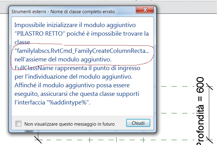

START WITH C # PROGRAMMING FOR REVIT ARCHITECTURE: I tried to do an exercise (file revit_2012_file_training.zip) that involves the creation of rectangular columns.
For this reason we created the class (PICTURE CREAZIONE FAMILYLABSCS.JPG):
C:\TEST\pil\FamilyLabsCS\FamilyLabsCS\FamilyCreateColumnRectangle.cs
I then created the file addin (see picture 0 ADDIN.JPG).
Then I open Revit Arch 2013 and when I click on "PILASTRO" me 'a mistake or misses the
“FamilyLabsCS.RvtCmd_FamilyCreateColumnRectangle”
contained in FullClassName (PICTURE ERROR.JPG). Why is that? Thanks for your cooperation.

The problem was with the entries in the .addin manifest file.
I have fixed the .addin file - removed the redundant accessibility tag and fixed the problem with the vendor description tag. And following this, the command was displayed successfully in the External Tools drop down list and did not show the error dialog you had attached.
The .addin file is attached with this post. Please change the path of the addin dll before using it.
There are some other problems with the code which you can now look into and fix - now that the command is accessible.

Now it works fine ....... Thanks for the help .......
I changed all the names related to layers, views, etc.. file in visual basic: they were in English rather than Italian
