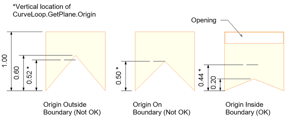

An additional aspect I've discovered:
When you remove the door outline from the outer loop then the opening can be added without raising the exception e.g.
Below works ok:
However below fails:
There is no difference in the outer loop apart from the removal of the door aspect.
Note that the exception is thrown when creating the opening not the panel so the panel with or without door is created fine. It is only when you add the opening to the panel with the door outline you get the exception.
Here is the information for the CurveLoop with door:
#Planar Loop
#Plane Origin: -165.201660016252,-109.960338847661,4.19190555044222
#Plane Normal: 1,0,0
#Loop is anticlockwise according to plane normal.
Line|-165.201660016252,-124.167471493235,11.4857251912482|-165.201660016252,-124.167471493235,-3.5527136788005E-15
Line|-165.201660016252,-124.167471493235,-1.77635683940025E-15|-165.201660016252,-114.453993603662,-1.77635683940025E-15
Line|-165.201660016252,-114.453993603662,-1.77635683940025E-15|-165.201660016252,-114.453993603662,5.28189701052064
Line|-165.201660016252,-114.453993603662,5.28189701052064|-165.201660016252,-109.860817750644,5.28189701052064
Line|-165.201660016252,-109.860817750644,5.28189701052064|-165.201660016252,-109.860817750644,-1.77635683940025E-15
Line|-165.201660016252,-109.860817750644,-1.77635683940025E-15|-165.201660016252,-91.3590725431041,-1.77635683940025E-15
Line|-165.201660016252,-91.3590725431041,-3.5527136788005E-15|-165.201660016252,-91.3590725431041,11.4857251912482
Line|-165.201660016252,-91.3590725431041,11.4857251912482|-165.201660016252,-124.167471493235,11.4857251912482
#Loop is closed.
Without door
#Planar Loop
#Plane Origin: -165.201660016252,-107.xxx-xxxxxxxx,5.74286259562412
Line|-165.201660016252,-124.167471493235,-1.77635683940025E-15|-165.201660016252,-91.3590725431041,-1.77635683940025E-15
#Loop is closed.
 ...and the forum (or something in-between) doesn't like the number:
Message 3 of 13

I think part of the number is perhaps being filtered out because it looked like a phone number.
Regarding the issue I think I'm getting to the bottom of the cause, looks like an error in the checking process to determine if an opening can be placed within the boundary. I noticed that when I varied the door height on the last example there was the possibility to place the opening without an issue (if door height reduced). So it got me thinking about the Origin of the Plane from CurveLoop.GetPlane. It seems to be the case that if the Origin of the CurveLoop that forms the AnalyticalPanel is outside the panel profile itself then you will not be able to add any opening to it via the API regardless of opening position. So in effect the geometry of the AnalyticalPanel in isolation is ruling out placing openings with the API that could be placed with the UI (which can't be right). The origin of the plane can't be manipulated it is an inherent value so a fix is required.
I've demonstrated this error in checking logic below with three variations of a simple shape on the XY plane.
In the above if the apex of the bottom triangle is 0.5 or greater then placement of the opening will fail.
Code used in above study:
Private Shared Function LN(ep0x As Double, ep0y As Double, ep0z As Double, ep1x As Double, ep1y As Double, ep1z As Double) As Line
        Return Line.CreateBound(New XYZ(ep0x, ep0y, ep0z), New XYZ(ep1x, ep1y, ep1z))
    End Function
    Public Function Obj_220604a(commandData As ExternalCommandData, ByRef message As String, elements As ElementSet) As Result
        Dim IntUIApp As UIApplication = commandData.Application
        Dim IntUIDoc As UIDocument = commandData.Application.ActiveUIDocument
        Dim IntDoc As Document = IntUIDoc.Document
        Dim Env = Function(H As Double) As CurveLoop
                      Dim LNSb As Curve() = New Curve(4) {}
                      LNSb(0) = LN(0, 0, 0,
                                   0, 1, 0)
                      LNSb(1) = LN(0, 1, 0,
                                   1, 1, 0)
                      LNSb(2) = LN(1, 1, 0,
                                   1, 0, 0)
                      LNSb(3) = LN(1, 0, 0,
                                   0.5, H, 0)
                      LNSb(4) = LN(0.5, H, 0,
                                   0, 0, 0)
                      Return CurveLoop.Create(LNSb.ToList)
                  End Function
        Dim LNSa As Curve() = New Curve(3) {}
        LNSa(0) = LN(0.01, 0.99, 0, 0.99, 0.99, 0)
        LNSa(1) = LN(0.99, 0.99, 0, 0.99, 0.8, 0)
        LNSa(2) = LN(0.99, 0.8, 0, 0.01, 0.8, 0)
        LNSa(3) = LN(0.01, 0.8, 0, 0.01, 0.99, 0)
        Dim CL_Opening As CurveLoop = CurveLoop.Create(LNSa.ToList)
        'The below 3 variations demonstrate that position of Plane.Origin of CurveLoop.GetPlane
        'for the AnalyticalPanel the opening is being placed in
        'governs if an opening can be placed in the AnalyticalPanel
        'i.e. if the Plane.Origin is on the boundary of the AnalyticalPanel or outside of it
        'then no opening will be able to be positioned on that AnalyticalPanel regardless of opening position
        'A simple shape on the XY plane containing 5 points is assumed in this test
        'The Plane.Origin value is found to be based upon the average of all line end points within the CurveLoop
        'Therefore the penultimate point in the loop can be given a Y value to demonstrate the three situations below:
        Dim Height1 As Double = 0.6 'Height of point (1+1+0+0+0.6)/5 = 0.52 (Lower than boundary point of 0.6 = NOT OK)
        Dim Height2 As Double = 0.5 'Height of point (1+1+0+0+0.5)/5 = 0.5 (At same height as boundary point = NOT OK)
        Dim Height3 As Double = 0.2 'Height of point (1+1+0+0+0.2)/5 = 0.44 (Higher than boundary point of 0.2 = OK)

Message 5 of 13
jeremy_tammik
Dear Richard,
Thank you for your report, reproducible case, clear description and careful in-depth analysis!
Sorry to hear about this.
I logged the issue REVIT-193494 [Analytical opening creation throws ArgumentException] with our development team for this on your behalf as it requires further exploration and possibly a modification to our software. Please make a note of this number for future reference.
You are welcome to request an update on the status of this issue or to provide additional information on it at any time quoting this change request number.
This issue is important to me. What can I do to help?
This issue needs to be assessed by our engineering team and prioritised against all other outstanding change requests. Any information that you can provide to influence this assessment will help. Please provide the following where possible:
  • Impact on your application and/or your development.
  • The number of users affected.
  • The potential revenue impact to you.
  • The potential revenue impact to Autodesk.
  • Realistic timescale over which a fix would help you.
  • In the case of a request for a new feature or a feature enhancement, please also provide detailed Use cases for the workflows that this change would address.
This information is extremely important. Our engineering team have limited resources, and so must focus their efforts on the highest impact items. We do understand that this will cause you delays and affect your development planning, and we appreciate your cooperation and patience.
Best regards,
Jeremy
Message 6 of 13
RPTHOMAS108
Thanks Jeremy
Below are my answers:
I'm mitigating by plotting model lines for such openings that the end user would then have to trace.
This issue will also affect the Autodesk Dynamo script that generates analytical elements. I've attached a file with two wall arrangements to demonstrate this (OneWillFail). So number of users affected = number of global Revit Structure users.
0
For Autodesk to estimate based on global users affected
Within year (based on my current publishing schedule)
Same result with 'Analytical Automation' via Autodesk toolSame result with 'Analytical Automation' via Autodesk tool
Regards
Richard

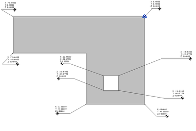

andrzej_malesa
Is that problem fixed by API DEV team?
I have the same problem during creation an openining in AnalyticalPanel.
Below is an example of slab with opening creation problem:
I think the problem is in algorithm of detecting outside/inside.
In my programs I am using ray crosing algo INPOLY.C as linked below, and it is excelent(I've made checking by iterating each CurveLoop ->Curve.Tessellate points)
https://www.visibone.com/inpoly/
Message 10 of 13
jeremy_tammik
The accompanying text that you point to is excellent too. Thank you for pointing that out and wishing you a nice weekend.
Message 11 of 13
jeremy_tammik
I checked the status of the development ticket REVIT-193553 Analytical opening creation throws ArgumentException for you. It has been closed and fixed, and the enhancement was release in Revit 2023.1 and Revit 2024.
Message 12 of 13
