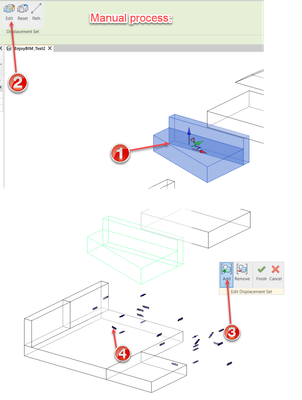

I try to create an python code to add elements (model text) to existing DisplacementElement Sets. It is possible to do it manually and I try to find a way to do it automatically with Python in my Dynamo Script. And in addition I'm not sure which method I should use.
Example of the manual process:
Do you think GetAdditionalElementsToDisplace() ( https://www.revitapidocs.com/2021.1/97d02f11-7308-579c-031a-5102dc40ae4f.htm ) is suitable method?
Goal of the Python Code is to add the elements in the first sublist ("idsToDisplace") to the first DisplacementElement Set. And the second sublist  to the to the second DisplacementElement Set and so on.
