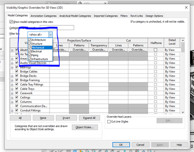

Dears,
i am asking how can i can Access Visibility and Graphics Filter List highlighted in above programmatically

I Don't think this can be set directly from the API.
But maybe it's a setting in the Revit.INI
Try this, the "CategoryDisciplineFilter" looks promising
https://help.autodesk.com/view/RVT/2024/ENU/?guid=GUID-30C62836-F3F1-4B78-B1AF-DB4E3FD79FDF

I tried it manually and succeeded in reading the data, but when assigning a specific list, it wasn’t mapped in Revit.
TripleM-Dev.net
You mean you changed the Revit.Ini?
The Revit.Ini (most setting) will be read on the launch, so setting the value while Revit is already running won't change that list.
Change it and then launch Revit, now it should use the list.
