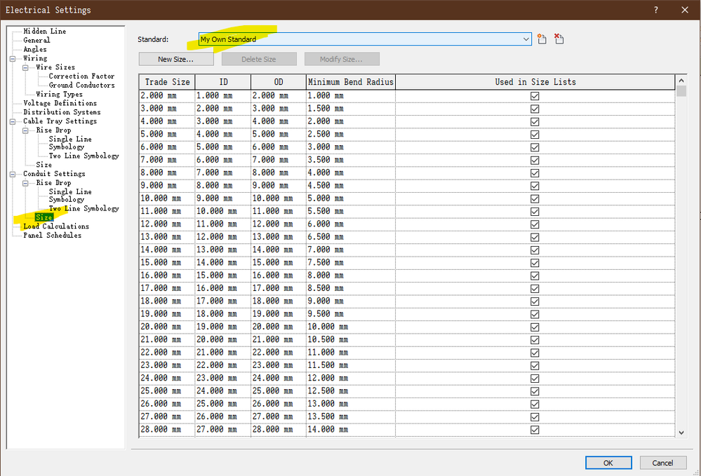

Suppose that I have created a new Conduit Size Standard named as "My Own Standard":
And I assigned this standard to a ConduitType within Revit UI:
Here comes the question:
Suppose that I've been give a Conduit element, how can I access which standard it's been assigned.
In the above mentioned case, I want to get "My Own Standard" from a Conduit element via API.
Thanks!

You can get the CONDUIT_STANDARD_TYPE_PARAM BuiltInParameter from the conduit type. I think that has what you're looking for.
