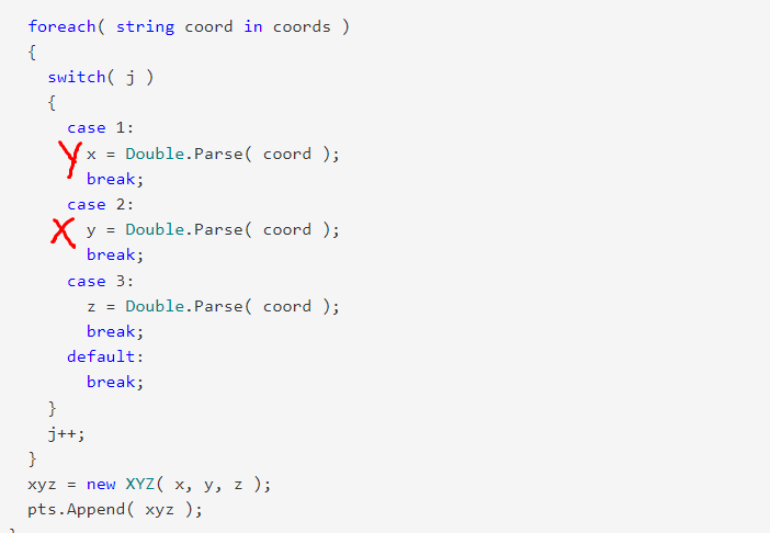

<P id="1">Y   X  Z</P>
This may be a bit off-topic. But I wonder about exporting toposurface to LandXML.
Why the order of collocation is (Y X Z) and not (X Y Z)

Actually, I do have an answer after all. Look at the LandXML specification for the P tag:
http://www.landxml.org/schema/LandXML-1.2/documentation/LandXML-1.2Doc_P.html#Link07F5D020
> A surface point. it contains an id attribute and a space delimited "northing easting elevation" text value.
