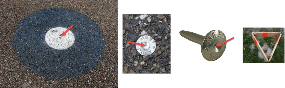

When you start a new project or have an existing one. The first thing to do is to define the shared coordinate where everyone sticks to.
This can be a physical object (survey marker) in the real world like you see below.
When you scan the new or existing location you could set the shared origin and publish it to all other team members.
