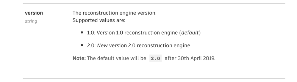

Hi Varun,
Yes, we are actively making performance & quality improvements and will be making feature updates as well. We recently released a big update with major quality improvements. You can find more details on this update here: https://forums.autodesk.com/t5/recap-forum/quot-save-as-quot-in-recap-pro-project-loss-quality-of-or...
To use the new update, you'll have to specify version=2.0 as a parameter to the POST photoscene API. API info can be found here: https://forge.autodesk.com/en/docs/reality-capture/v1/reference/http/photoscene-POST/
Feel free to email me at Karthik.nathan@autodesk.com if you have any questions.
