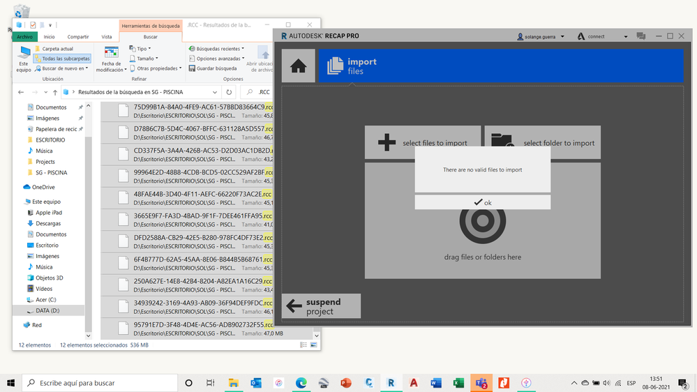

How can I open the scan file in 3D software if the file format is diff, llt, rcc, etc.?
Recap pro doesn't allow me to import rcc files.

ReCap doesn't allow you to choose .rcc file when importing raw scans.
However, you can create a new project and then drag and drop .rcc files to the importing view in order to import .rcc files.

I've tried, but when I create a new project and import the rcc files it gives me the following message:

which ReCap version are you using? I just tried in ReCap2022 and it works.

Thank u so much

i have recap pro 2022 - 30day trial version. will this do for me? or i have to go for license copy

It works in free / trial version
