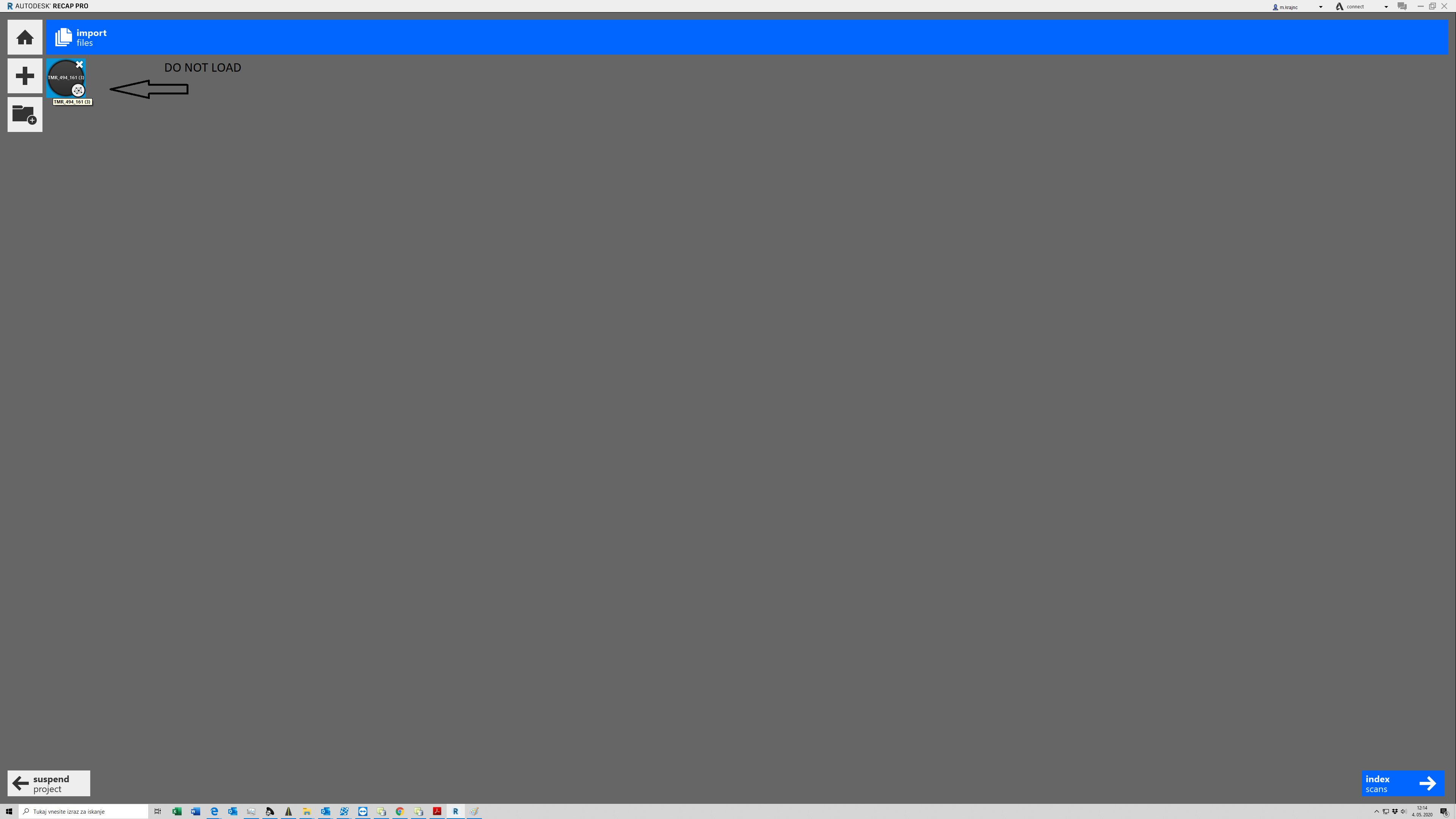

When i try to open a .las or .laz (LIDAR) file in recap(2021 also try in 2020) it doesnt load the file and then nothing happens. The file size is about 30MB.

For decompressing or converting from .zlas to .las i use LAS optimizer (https://www.arcgis.com/home/item.html?id=787794cdbd384261bc9bf99a860a374f) i think it is a similar software as LASliberator. I tried with "liberator" and the Recap also did nothing. When i load the file in recap it shows it on upper left corner but doesnt load it. I can also index file. Then it shows me the remaining time which is a few minutes but after a few hours nothing happens. Only one time ReCap load file and made a point cloud from .laz.file and the all process took few seconds so i don't think it's a problem with comp. hardware.
I really don't know what to do.

I made a repair and Re-installed Recap  (2020 and 2021 version 7.0.....). The problem remains the same.
is it possible that something is wrong with ReCap settings?

here is my work flow (attachment)

I installed the recap on another computer and got error message "could not import scan!" I think
it could be a problem in the .las/.laz files...
