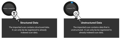

hi @Anonymous,
no problem! I was using ReCap PRO yes, but the tool should be available in the non PRO version as well, assuming that your data is Structured. You can identify whether the data is structured or unstructured when you import the scans. Please review this article for Importing Scan Files
Pay careful attention to the symbol in the bottom right hand corner of the scan data (see image below)
If it is structured data, you should have the option for "realview" mode, if it is unstructured then you will not.
