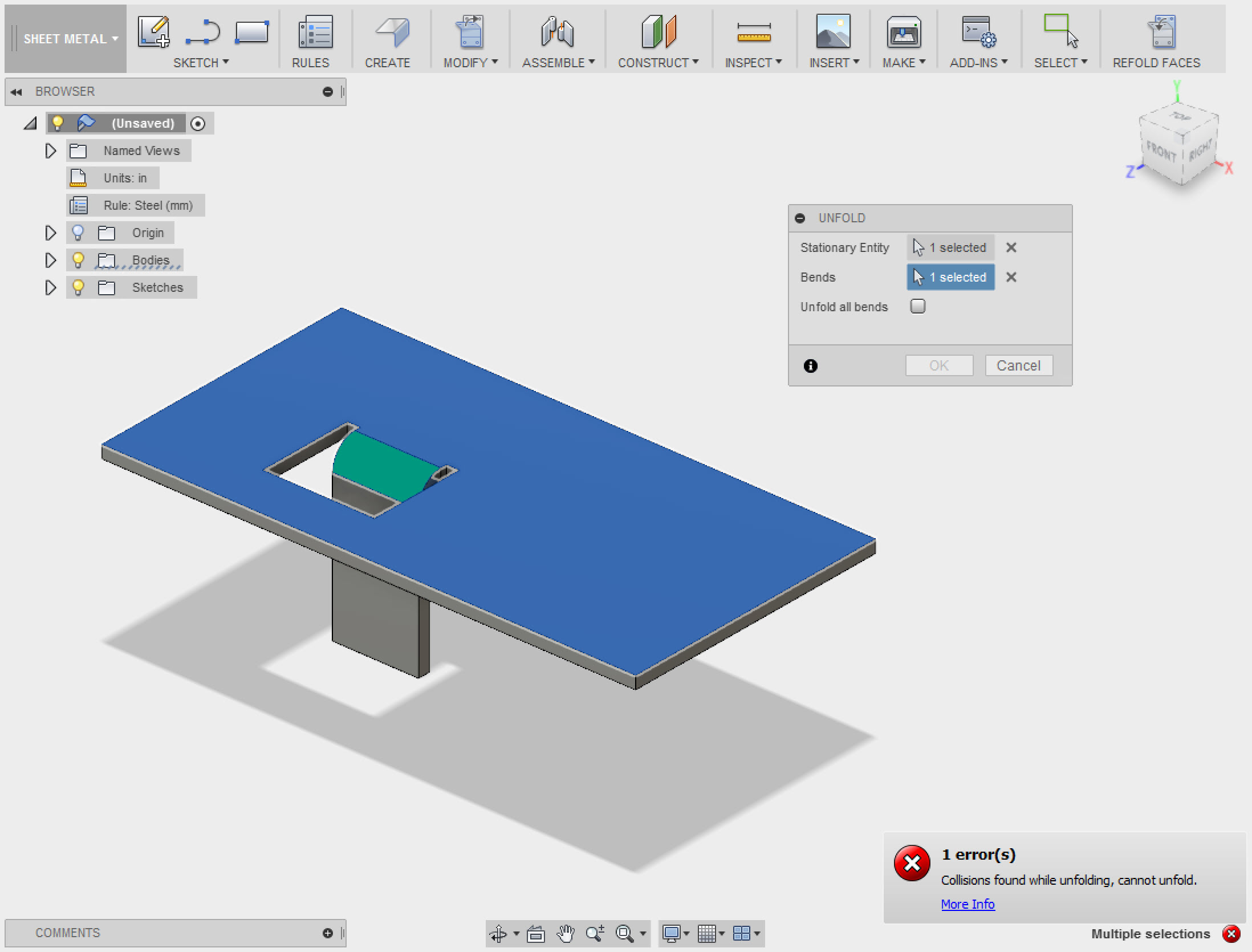

oakleym
Allow a part that has overlaps to be flattened with a warning, and highlight the problem area.
It is often easier to fix the problem in a flattened state vs guessing in the formed state.
In the attached image i would normally flatten this and do a cut to remove the overlap.
https://damassets.autodesk.net/content/dam/autodesk/logos/autodesk-logo-primary-rgb-black-small_forum.png
