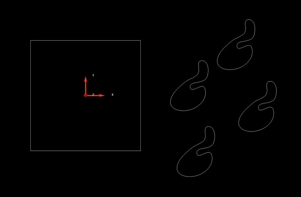

Is there a way to allow Powershape to freely rotate a part to fit it in the stock sheet? The only option I see is to select a specific angle like 90. It seems like you can type in multiple options, but that would require typing in every number between 0 and 180 and decimals may be required too. If you look at the attached picture, green outlines are the sheets and white and red outlines are the parts. All the parts are at random angles. I want Powershape to rotate them as needed to best fit into the stock. Otherwise, I have to rotate every part individually to the current plane, then nest them. With 50+ parts, this is very tedious.
Nikola_Kolev
beforebeforeafterafter
