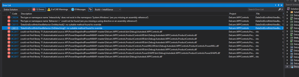

I Cloned the API and tried building it, but I get 12 errors.
I'm not quite sure what connection this has with my problem, can you please elaborate?errorlistbuild.png

The missing reference should be here:
C:\Program Files (x86)\Microsoft SDKs\Expression\Blend\.NETFramework\v4.0\Libraries\System.Windows.Interactivity.dll
Perhaps when you installed Visual Studio you didn't choose for "Blend" to be installed?
I thought that if you could debug the API you could find out what values PowerShape was giving back and why the API wasn't able to generate a bounding box value from them.
You could always disable the WPF projects in Visual Studio as these are not necessary for what you are testing.

I have it installed but apparently Microsoft made blend or some parts of it opensource, so the places which these are installed changed. I'm not quite sure how it works, so I opened it on VS 2017 and now it only gives 18 warnings.  ( https://devblogs.microsoft.com/dotnet/open-sourcing-xaml-behaviors-for-wpf/)

I've just updated the code on GitHub.  It should now take that reference from NuGet.  If you grab the latest version of the code and build then it should work...  See how you get on with it.
