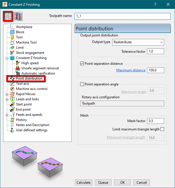

alexandre.pintoAGNAU
@Anonymous
I edited your toolpath and changed the point distribution.
Output Type = Redistribute
Tol factor = 1
tick point separation distance
maximum distance = 100 (mm)
untick point separation angle.
Calculated the toolpath and simulated, and I had no issues at all.
The reason you had issue are simple.
- the tool Z axis aligned to the 6th axis is great at aligning the 3 axis responsible for wrist singularity (axis 4, 5 and 6). I thought I had made it clear previously.
- the lack of point means the simulation solver did not do a good job at defining the robot posture at the edges of the part. You only had points at the corners, so always a good idea to "help" the solver by adding points
- the position orientation of the part is again ideal for singularities and axis limits.
if you are going to keep this configuration of teh hardware you will always have issue that is for sure.
solutions:
- change point distribution (add more points)
- instead of vertical toolpath edit the tool axis to have a lean/lead angle, that will force axis 4, 5 and 6 NOT to be aligned
- think of adding an angle to the end effector/spindle (so you reduce alignment of axis axis 4, 5 and 6 )
- think of changing the part position (location/orientation)
luckily it is easy and fast to make all these changes inside PowerMill, and you are able to see end result quite fast.

Message 11 of 13
ChristopherMarion
@Anonymous
I followed @alexandre.pintoAGNAU advice with adding points to the toolpath and it worked perfectly.
Since you are just starting with PowerMill, modifying the point information of the toolpath is located within the strategy form.  Just right click on the toolpath in the Explorer and click on "Settings".  That will open the toolpath form back up.  Then select the Recycle icon and the top left corner of the form to access the parameters.
To follow Alex's recommendations, go to the Point Distribution page.  Fill in the information and Re-calculate the toolpath.
