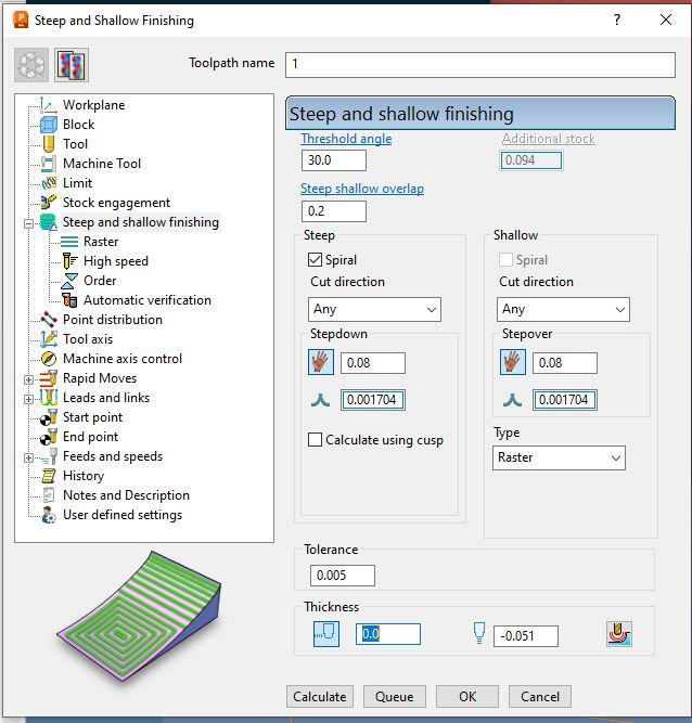

Message 6 of 12
Pijetro
Thickness field is the way to go...
If you ever need to do 2D orbits, simply input your Radial thickness, and set axial thickness to zero...

Message 8 of 12
Pijetro
And of course, the other advantage to this...
If you ever need to do localized thicknesses, like Collision surfaces, or additional safety allowance on a face, etc...The option is always open to use the surface thickness tab...

Message 11 of 12
I use the thickness to set orbit/undersize also. If you are using 2D orbit, the Z is set to size though. We just put in a Makino and Erowa cell for our edm work and are using the rough(.01 orbit), semi(.008 orbit), and finish(.005 orbit) system now. I'll attach a macro that I use to accomplish this for you to check out if you want. I'm not great with macros but this works for me. Maybe you could make some suggestions for improvement too.
