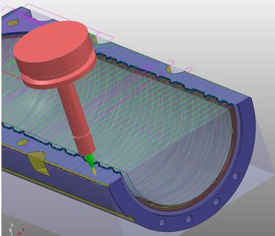

Dear all
Can you help me . i have issue with sCapture.JPGurface projection finishing toolpath.as you can see on the picture.
I look for hidden commands to define the distances end  limits of surface projection.
Thank you in advance

dames99
EDIT SURFPROJ AUTORANGE ON
Real $rangemax=0
Real $rangemin=0
$rangemax=INPUT "Enter maximum +maximum range"
$rangemax=INPUT "Enter maximum -minimum range"
EDIT SURFPROJ AUTORANGE OFF
EDIT SURFPROJ RANGEMAX $rangemax
EDIT SURFPROJ RANGEMIN $rangemin
Jonathan.Artiss-DSI
@jeanmarc.teste
You can copy paste this command into the echo commands window and it will populate a hidden page in the projection surface toolpath.
preview strategy_projection_range_form
Open the page in the toolpath window and enter a min max value.

M_Hennig
I believe the above fix only works for surface finishing toolpaths, you must use the type in commands for the others. Wouldn't it be nice to just have this part of the original form, instead of typing in little top secret commands that most users know nothing about..??
