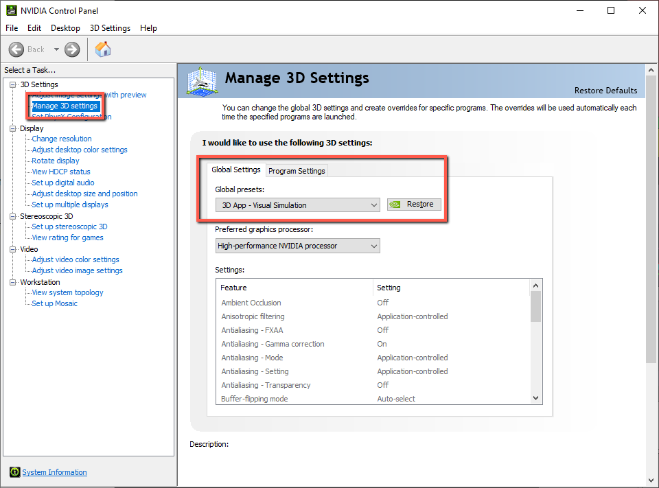

Update your graphics driver, set the manage 3D setting to 3D app - Visual Simulation.
Empty your %TEMP% directory.
Shut off anti virus.

Where do I find this "set the manage 3D setting to 3D app - Visual Simulation"?
I haven't been able to find that specific setting on my video card settings or anywhere else.
Message 8 of 12
Jonathan.Artiss-DSI
in reply to: Anonymous
Open the NVIDIA Control Panel and go to the manage 3D setting.
