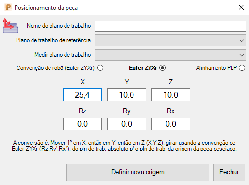

rafael.sansao
Hi @alexandre.pintoAGNAU,
Are the values always shown in millimeters in the plugin?
Check the attached image. The code executed is:
MODE NOGUI COORDINPUT COORDINATES -1 -0.393700787401575 -0.393700787401575
Values are being displayed in millimeters and running in inches.
Should not I see the values in inches in the plugin?
Rafael Sansão
OptiNC - www.optinc.tech
Hi Rafael,
I did not mention this before, so my answer was incomplete - only issue is Industrial Robots run in SI units, this means they use metric not inches!
I have driven a few robots in US and they ran mm. I have run PM code on hundreds of robots elsewhere and all in mm.
Even if on an industrial robot you can view the feed/speed in inches/min/sec it will still run in mm.
The menu you have chosen is ideal example.
After creating the worklplane (G54) on the part by 3 point method, for example, you will read the position of the part/workplane relative to the robot world coordinate (robot ZERO). This is read on the teach pendant, and is displayed in mm
And the units displayed are generally in mm, so we have the menu in mm, because these are the units you will see on the teach pendant.
If PM is in inches:
- tool creation in is inches
- import of tap file would also be in inches
- feedrate etc in inches
Output file after post processed will be in mm because of the Robot units.
