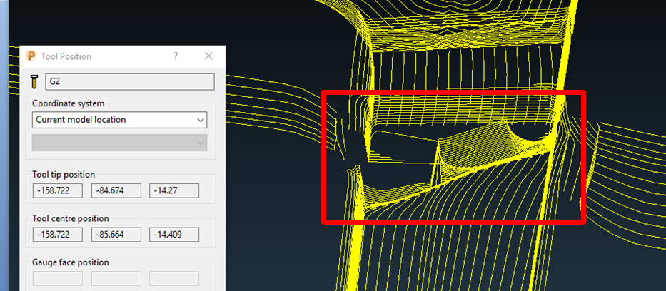

How could I check all my toolpaths, if they are corrupted or not?

@kukelyk Hi. Are there any 'obvious' gaps in the project? If not, this may be a case that this check is being too strict: it checks that the distance between the end of one toolpath component and the start of the next is less than the machining tolerance. If the tolerance is very fine and the toolpath coordinates large, it is possible for some numerical discrepancies to result in a false positive.
As for checking all the toolpaths in one go, the only solution that I can think of is to put them all in an NC program and try to write them out; I don't recall any other tools that we provide that could help, unfortunately. That won't tell you where the gaps are though. It would be better if the error message provided that information, at the very least. I'll see what can be done about that. Is it possible for you to provide a project that shows this problem please?
Does re-applying the links make the error go away? - If you are able to provide a project, please provide a version before the links are re-applied Thanks.
I have received this msg about 2-3 times in the last 3 yrs, scared the sh*t out of me thinking that I have to redo that toolpath but fortunately, all it took was to re-apply the leads/links and all was ok
Do you use the corner clearance strategy often? I find results like these turn me off to the strategy
@kukelyk Hi. Thanks for the data. The gap is around: -131.08, 29.42, 39.5. If you zoom in you'll see a small segment. The odd thing is that the segment is open but the lead in and lead out are both connected to the same end. The bug/error is that this this small segment has been mistaken for a closed segment. - It looks as if some changes have been made in a subsequent codebase to improve this. The toolpath was calculated in 1187262. Are you using a later codebase now?
