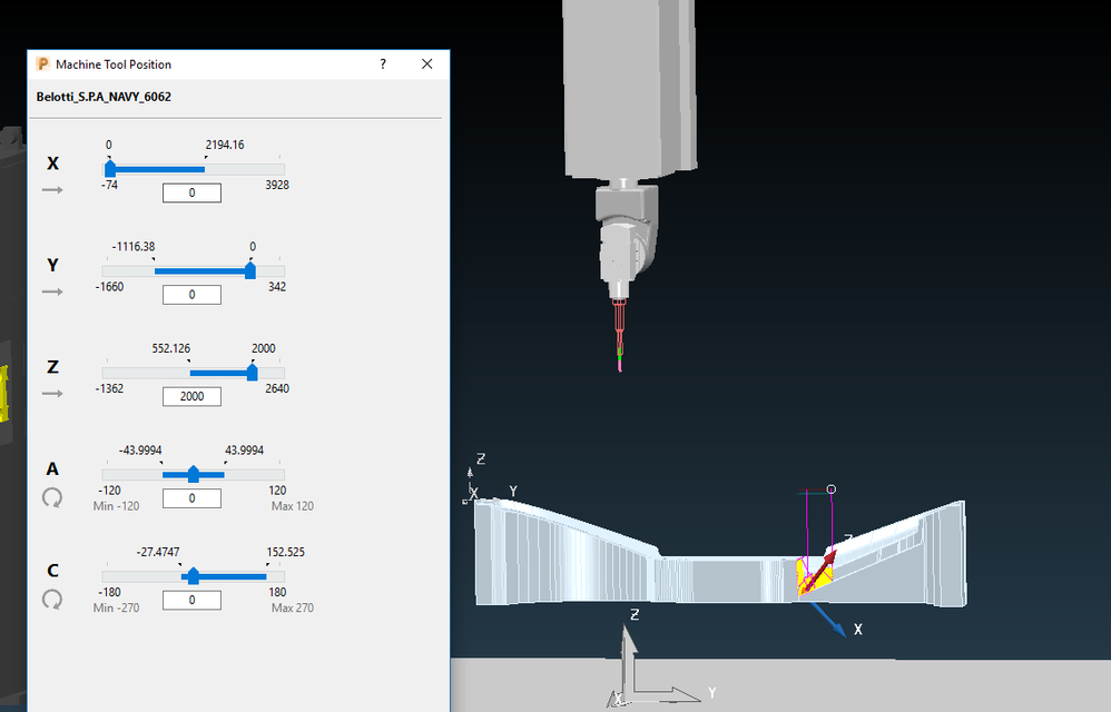

I am having issues when I send the program out to the machine, the simulation and the actual position of the machine don’t look the same. This has caused a few crashes for us.
This one shows my program, you can see the head is facing towards us and the machine position for A and C axis is the same as the nc code I have written.

I was thinking would this be that the machine is going the quickest way to the position.
For example in this case from the home position it had to rotate 27.48 degrees to reach that position in picture 3, but to reach the correct position it would have to rotate 152.52 degrees.
Just a thought.
Would there be a way to fix this?  As it’s causing major issues for us as we have very long programs and have to leave the machine running a lot.

First things first, the component is being aligned on the machine using a probe... so it's not sitting exactly as we see inside PowerMill, despite the values in the control looking the same (i.e. there's an offset in the control which aligns the part).
This is the underlying issue.
However, it seems the post processor being used isn't the one that was originally provided for this machine.  I have now provided the original post and I am told that the simulation / code/ machine now match.
This is in the testing stage but for the benefit of the forum post appears to be solved.
