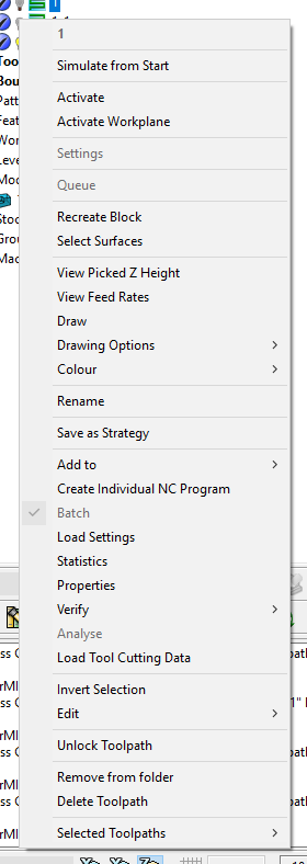

Thank you for your care and efforts, Mateusz. I don't have any problem with creating that custom menu at the buttom of the context menu. I want to embed some commands in the place like the highlighted ones below.
Yes, iamcdn. I'm just learning, for example adding block command at above of the recreate block command. I took a look at the files in the address you provided but it was somehow confusing.
_________________________________________________________
Open the explorer.ppm file. Do a search for "Load Components" and just above that line add the circled part with the location to your macro
